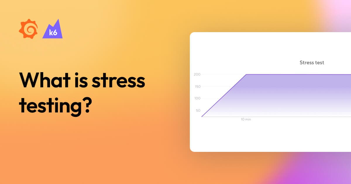

Stress testing assesses how the system performs when loads are heavier than usual.

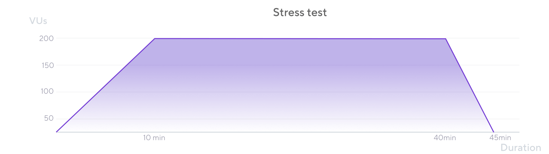

The load pattern of a stress test resembles that of an average-load test. The main difference is higher load. To account for higher load, the ramp-up period takes longer in proportion to the load increase. Similarly, after the test reaches the desired load, it might last for slightly longer than it would in the average-load test.
Stress test overview chart in Grafana k6.
In some testing conversations, stress tests might also be called rush-hour, surge, or scale tests.

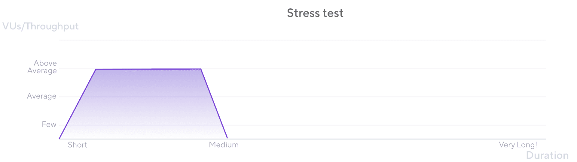

Stress testing in k6
The load in a stress test starts in a way that resembles load in an average-load test. The difference is that it reaches a higher level of load over the course of the test.
  1. Increase the script’s activity further in a slower ramp-up until it reaches an above-average number of users or throughput.
  2. Maintain that load for a while.
  3. Depending on the test case, stop or ramp down gradually.

The VU or throughput chart of a stress test looks similar to this:
Stress test chart in Grafana k6.
Note that similar to the average-load test, the stress test starts at 0 but increases beyond the point tested in the average-load type. The ramp-up and ramp-down periods are longer to allow for a more realistic response.
