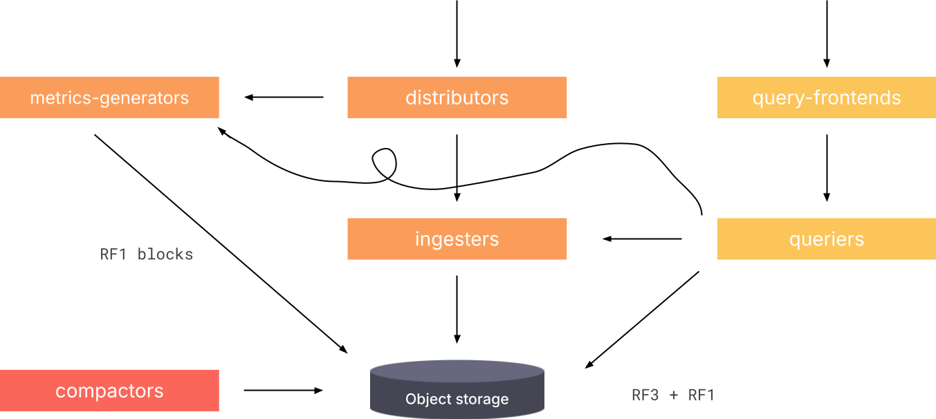

The current Tempo architecture includes distributors, ingesters, query frontend, queriers, compactors, object storage, and the metrics-generator.
Refer to Tempo architecture for more information.
The diagram illustrates the current Tempo architecture.

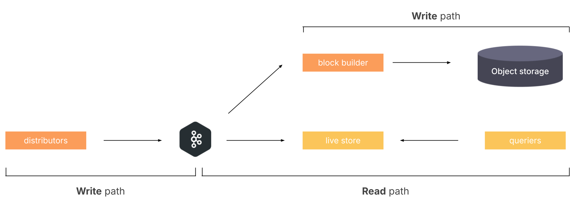

Project Rhythm works as follows:
- Distributors write incoming requests to Kafka.
- Ingesters are substituted by live-stores, a read-path component, replaying from Kafka. Live-stores responsibility is to serve trace queries
- A new component, the block-builder, is introduced to the write path. This component is tasked with replaying from Kafka to build blocks which are sent to long-term storage.
