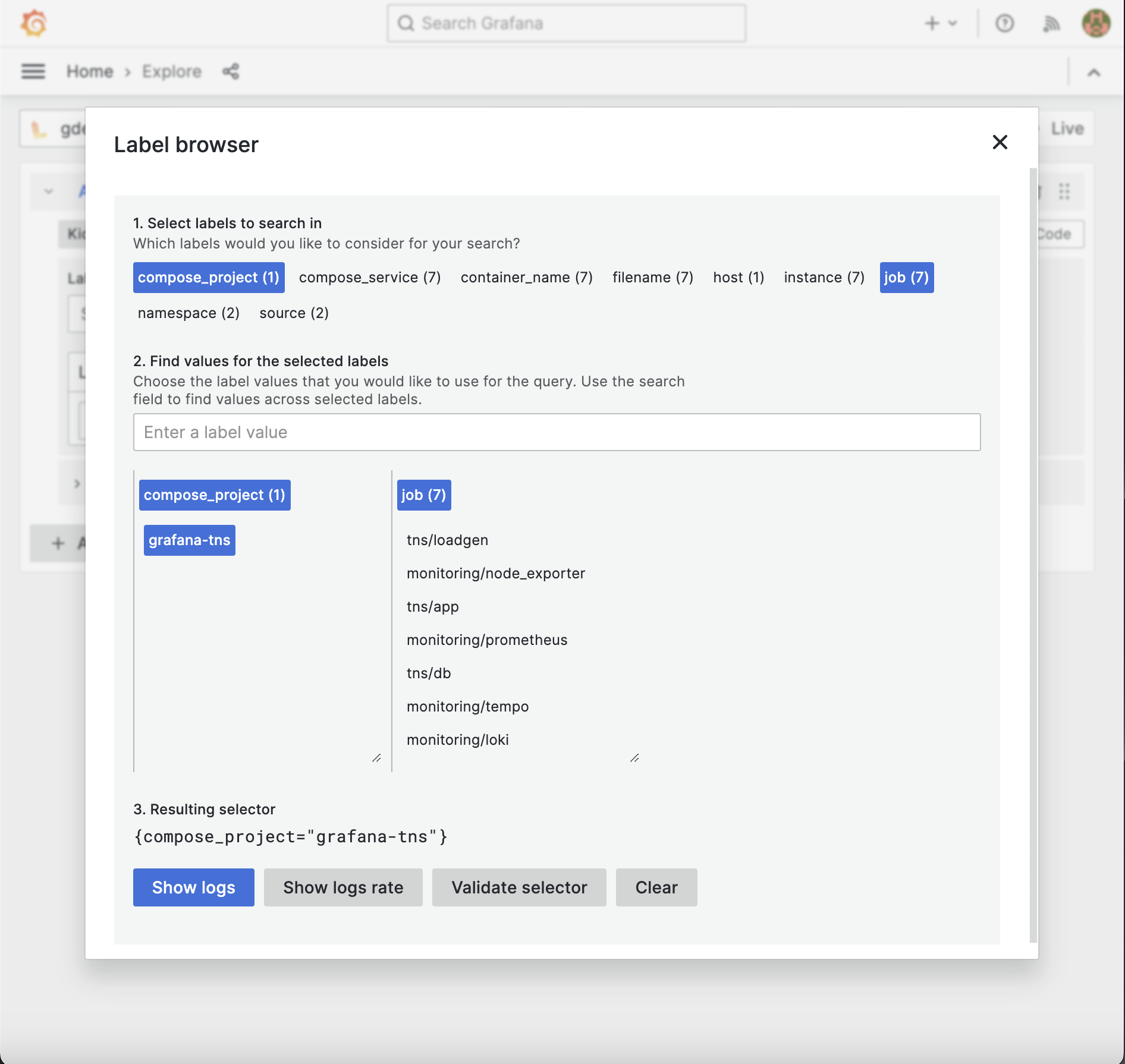

Label browser
You can use the Loki label browser to navigate through your labels and values, and build queries.
To navigate Loki and build a query:
- Choose labels to locate.
- Search for the values of your selected labels. - The search field supports fuzzy search, and the label browser also supports faceting to list only possible label combinations.
- Choose a query type between logs query and rate metrics query. You can also validate the selector.
