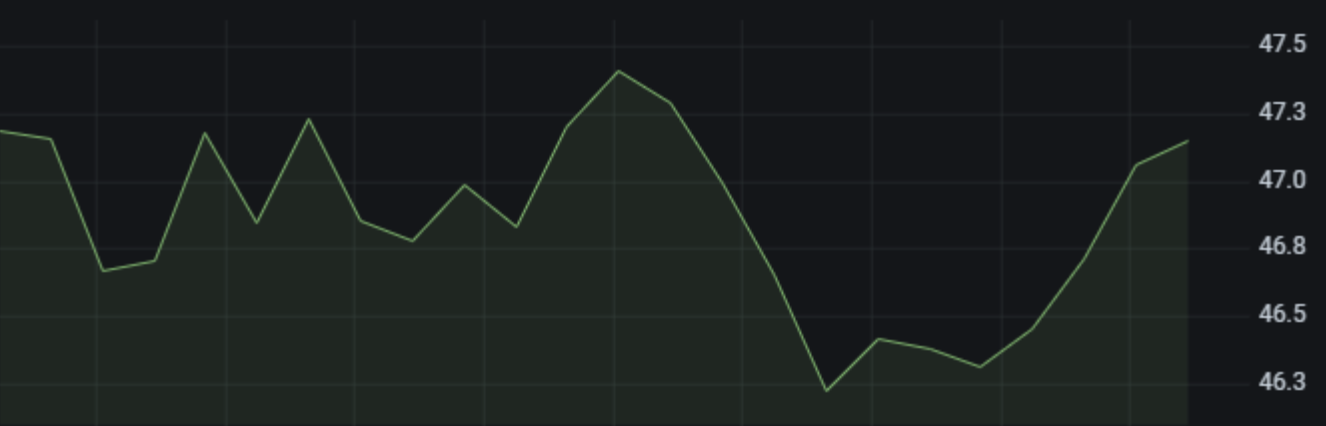

Select the placement of the Y-axis.
Auto
Grafana automatically assigns Y-axis to the series. When there are two or more series with different units, then Grafana assigns the left axis to the first unit and right to the following units.

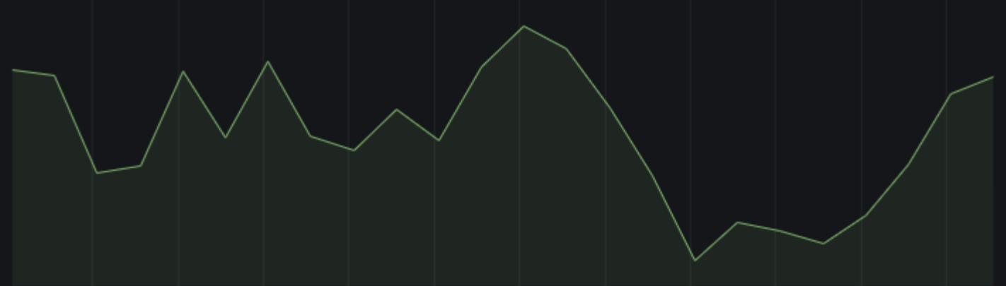

Hidden
Hide the Y-axes.

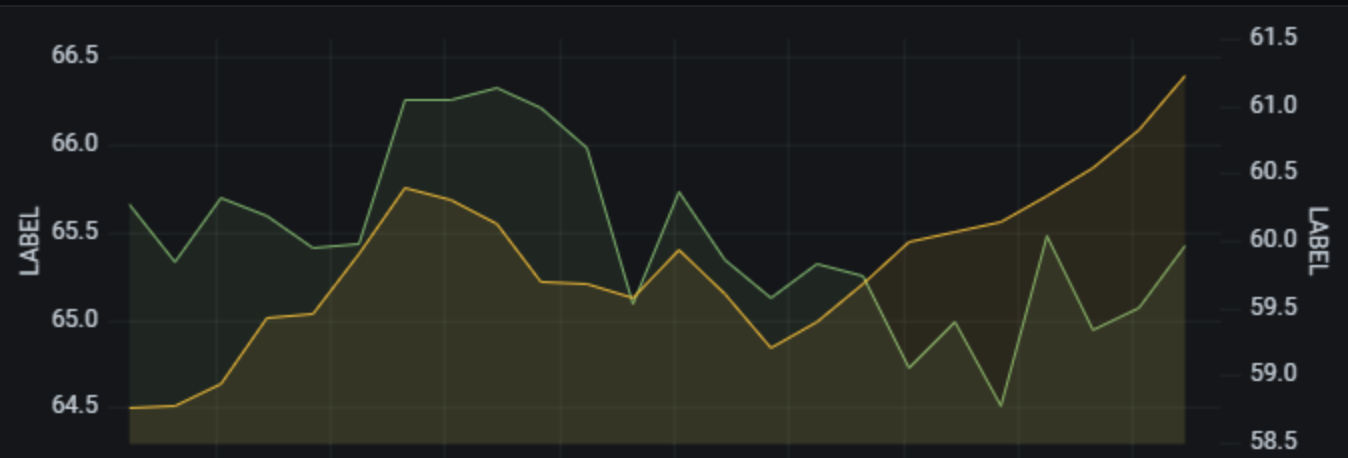

Label
Set a Y-axis text label.
If you have more than one Y-axis, then you can give assign different labels in the Override tab.

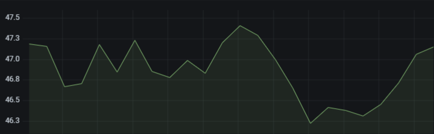

Width
Set a fixed width of the axis. By default, Grafana dynamically calculates the width of an axis.
By setting the width of the axis, data whose axes types are different can share the same display proportions. This makes it easier to compare more than one graph’s worth of data because the axes are not shifted or stretched within visual proximity of each other.
