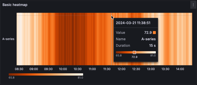

Show color scale
When you set the Tooltip mode to Single, this option is displayed. This option controls whether or not the tooltip includes the color scale that’s also represented in the legend. When the color scale is included in the tooltip, it shows the hovered value on the scale:
Heatmap with a tooltip displayed showing the hovered value reflected in the color scale
