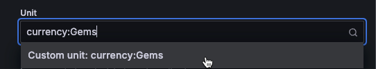

To set a custom unit, enter the unit you want to use and then select it in the drop-down. It’ll be the last option listed. For example, if you enter a unit called “Hearts”, the drop-down will then include the option Custom unit: Hearts.
You can further define a custom unit with specific syntax. For example, to set a custom currency unit called “Gems”, enter currency:Gems in the field. The drop-down will include the option Custom unit: currency:Gems:

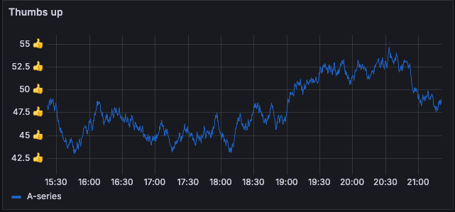

You can also paste a native emoji in the Unit drop-down and select it as a custom unit:
