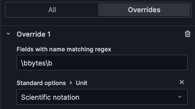

For example, you can override the default unit measurement for all fields that include the text “bytes” by adding an override using the Fields with name matching regex matcher and then the Standard options > Unit setting to the override rule:

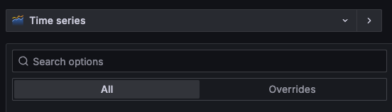

After you’ve set them, your overrides appear in both the All and Overrides tabs of the panel editor pane:
