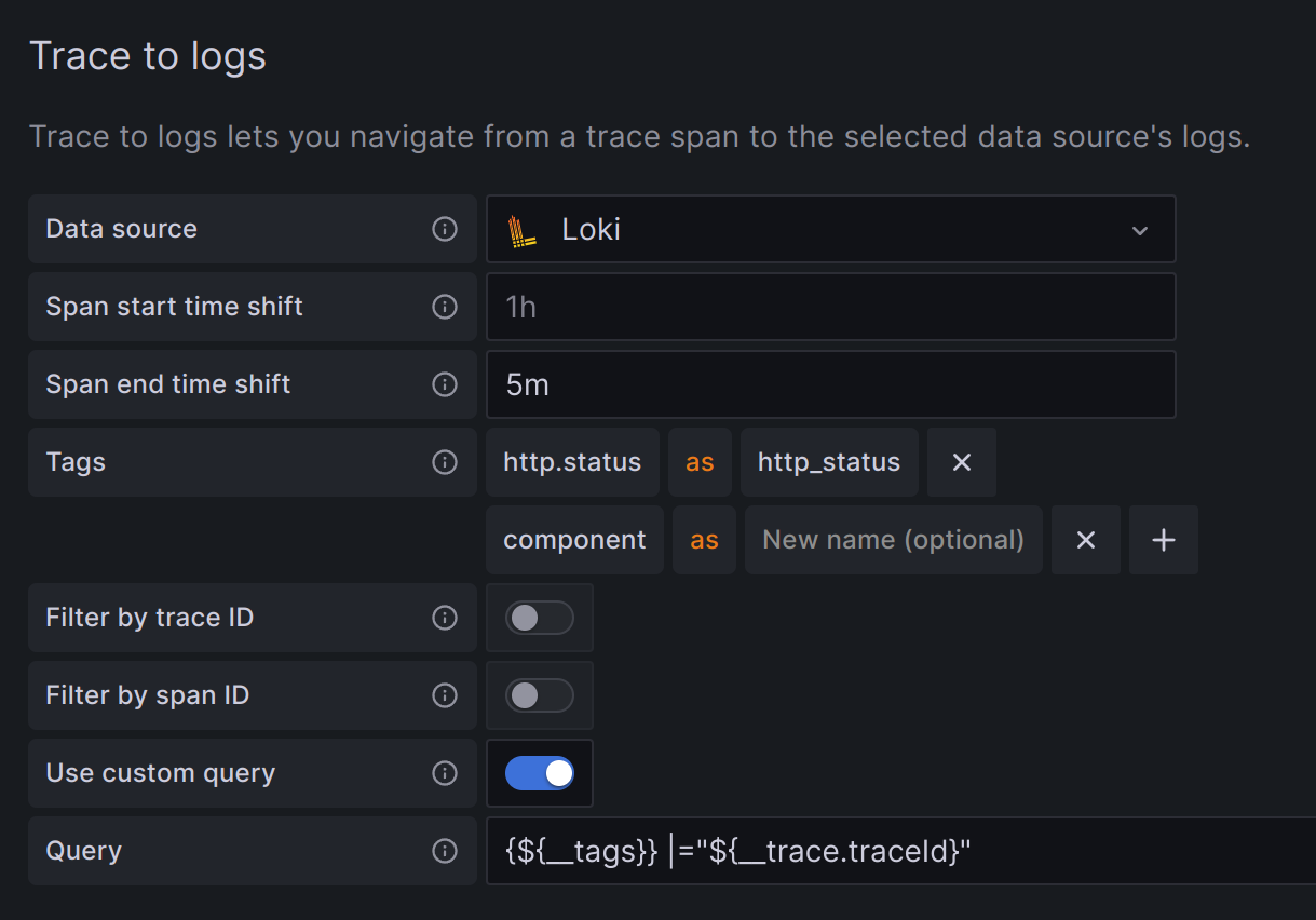

Trace to logs
Trace to logs settings
Note
If you use Grafana Cloud, open a support ticket in the Cloud Portal to access this feature.
The Trace to logs setting configures the trace to logs feature that is available when you integrate Grafana with Zipkin.
There are two ways to configure the trace to logs feature:
  • Use a simplified configuration with default query, or
  • Configure a custom query where you can use a template language to interpolate variables from the trace or span.
  1. Select the target data source from the drop-down list.
    You can also click Open advanced data source picker to see more options, including adding a data source.
  2. Set start and end time shift. Since the logs timestamps may not exactly match the timestamps of the spans in the trace, you may need to widen or shift the time range to find the desired logs.
  3. Optionally, select tags to map. These tags can be used in the custom query with ${__tags} variable. This variable will interpolate the mapped tags as list in an appropriate syntax for the data source and will only include the tags that were present in the span omitting those that weren’t present. You can optionally configure a new name for the tag. This is useful when the tag has dots in the name and the target data source does not allow using dots in labels. For example, you can remap http.status to http_status. If you don’t map any tags here, you can still use any tag in the query like this method="${__span.tags.method}".
  4. Skip Filter by trace ID and Filter by span ID settings as these cannot be used with a custom query.
  5. Switch on Use custom query.
  6. Specify a custom query to be used to query the logs. You can use various variables to make that query relevant for current span. The link will only be shown only if all the variables are interpolated with non-empty values to prevent creating an invalid query.

The following table describes the ways in which you can configure your trace to logs settings:
Setting nameDescription
Data sourceDefines the target data source. You can select only Loki or Splunk logs data sources.
Span start time shiftShifts the start time for the logs query, based on the span’s start time. You can use time units, such as 5s, 1m, 3h. To extend the time to the past, use a negative value. Default: 0.
Span end time shiftShifts the end time for the logs query, based on the span’s end time. You can use time units. Default: 0.
TagsDefines the tags to use in the logs query. Default: cluster, hostname, namespace, pod, service.name, service.namespace. You can change the tag name for example to remove dots from the name if they are not allowed in the target data source. For example, map http.status to http_status.
Filter by trace IDToggles whether to append the trace ID to the logs query.
Filter by span IDToggles whether to append the span ID to the logs query.
Use custom queryToggles use of custom query with interpolation.
QueryInput to write custom query. Use variable interpolation to customize it with variables from span.
