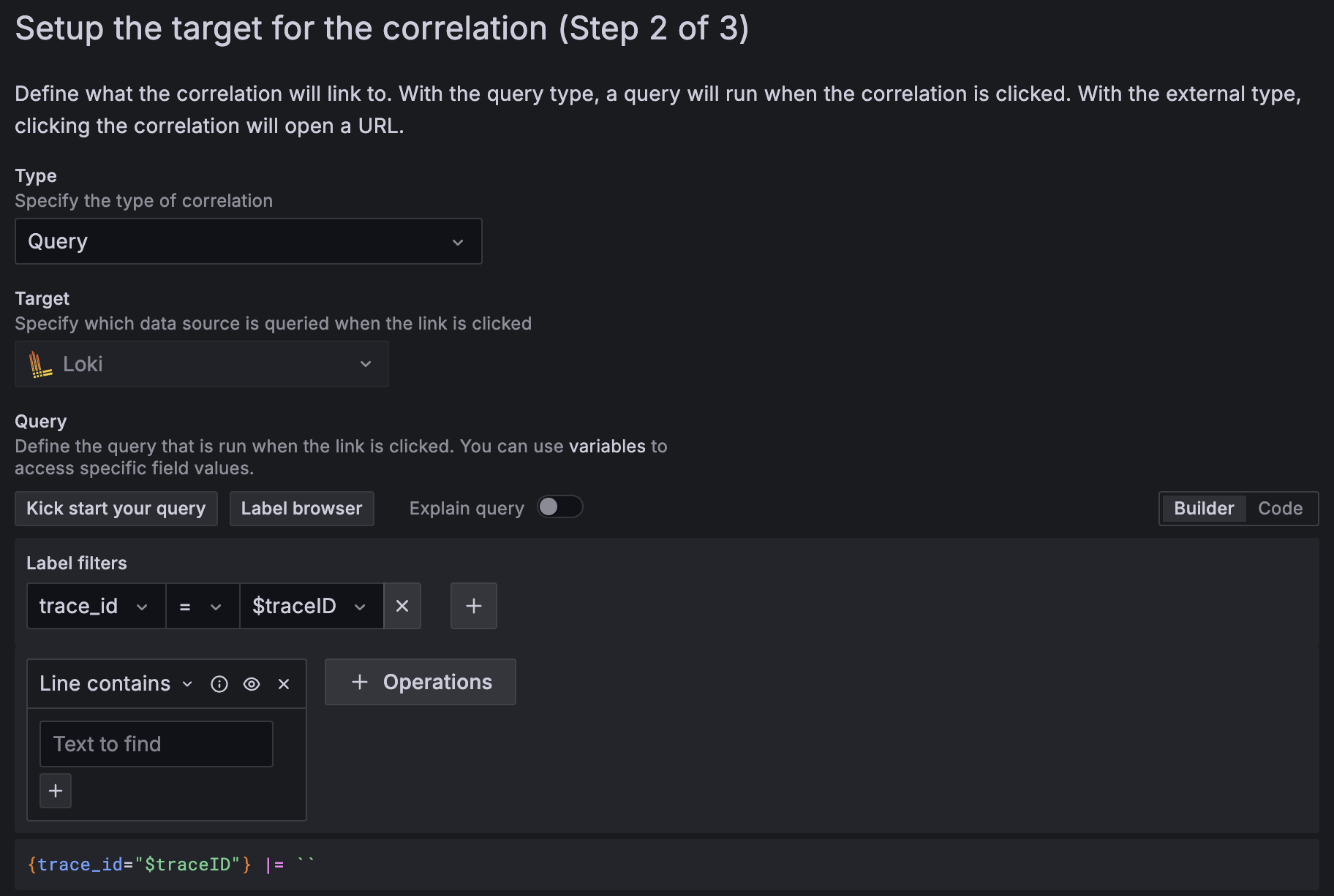

  5. On step 2, configure the correlation target.
    • Select the Type drop-down list and choose Query to link to another data source or choose External for a custom URL.
    • For a query Target, select the target drop-down list and select the data source that should be queried when the link is clicked. Define the target query.
    • For an external Target, enter the External URL.

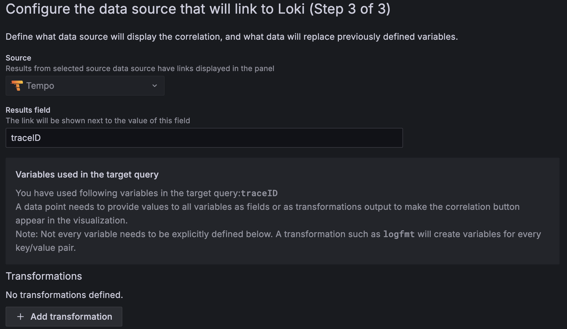

  6. On step 3, configure the correlation data source:
    • Select your Tempo data source in the Source drop-down list.
    • Enter the trace data variable you use for the correlation in the Results field.
    • Optionally, add one or more Transformations to parse the trace data into additional variables. You can use these variables to configure the correlation Target.

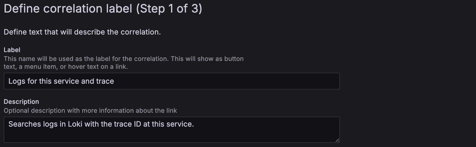

  1. On step 1, add a new correlation with the label Logs for this service and trace and an optional description.

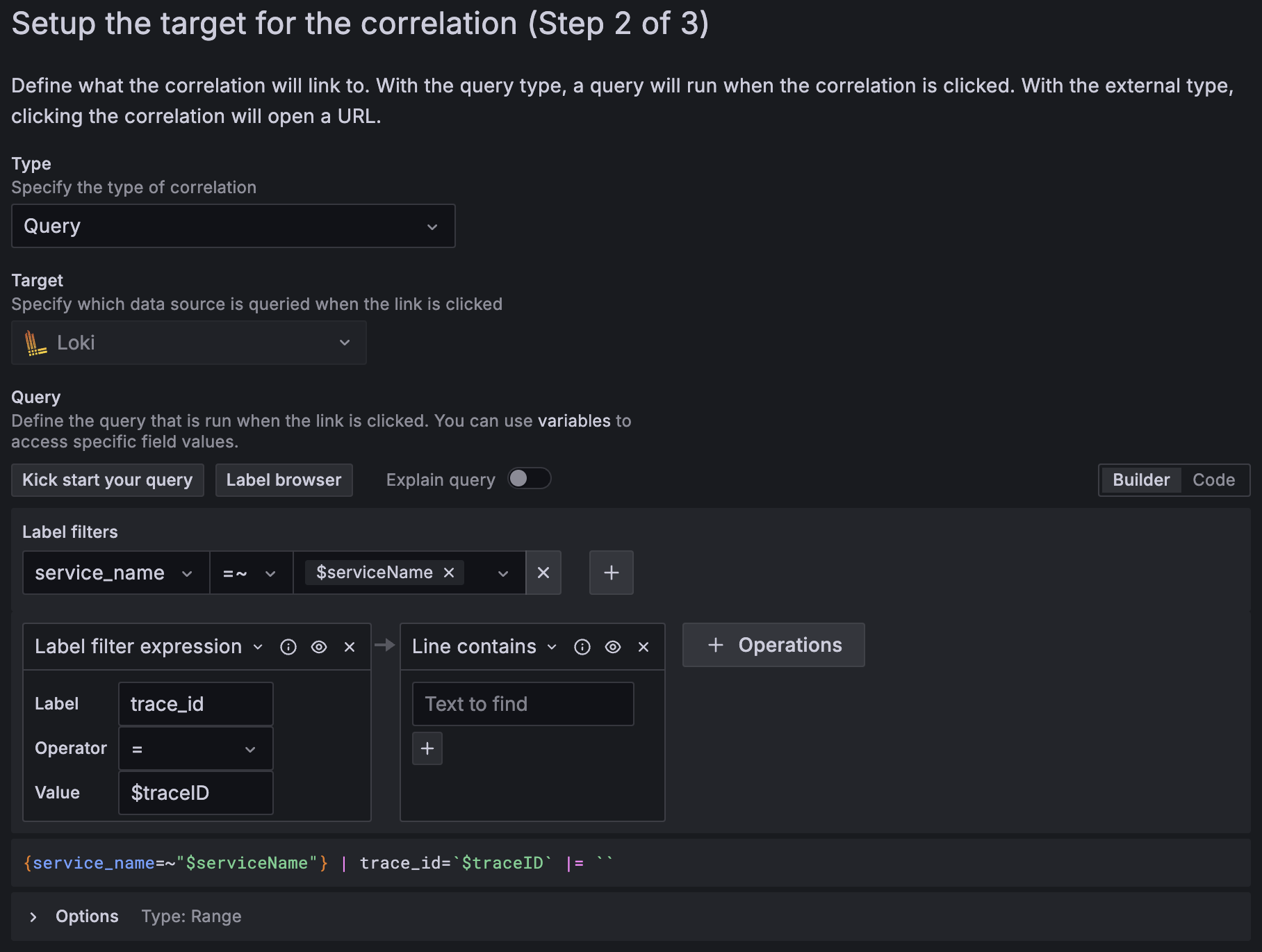

  2. On step 2, configure the correlation target:
    • Select the target type Query and select your Loki data source as Target.
    • Define the Loki query, using serviceName and traceID as variables derived from the span data:
      {service_name="$serviceName"} | trace_id=`$traceID` |= ``
      Using correlations for a trace

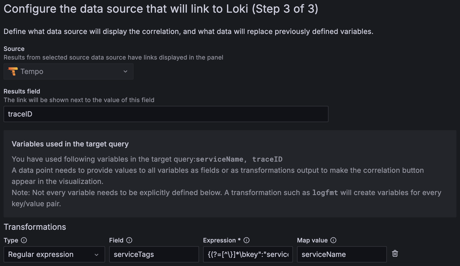

  3. On step 3, configure the correlation source:
    • Select your Tempo data source as Source.
    • Use traceID as Results field.
    • Add a new transformation to extract the serviceName from the span serviceTags using the regular expression:
      {(?=[^\}]*\bkey":"service.name")[^\}]*\bvalue":"(.*?)".*}
