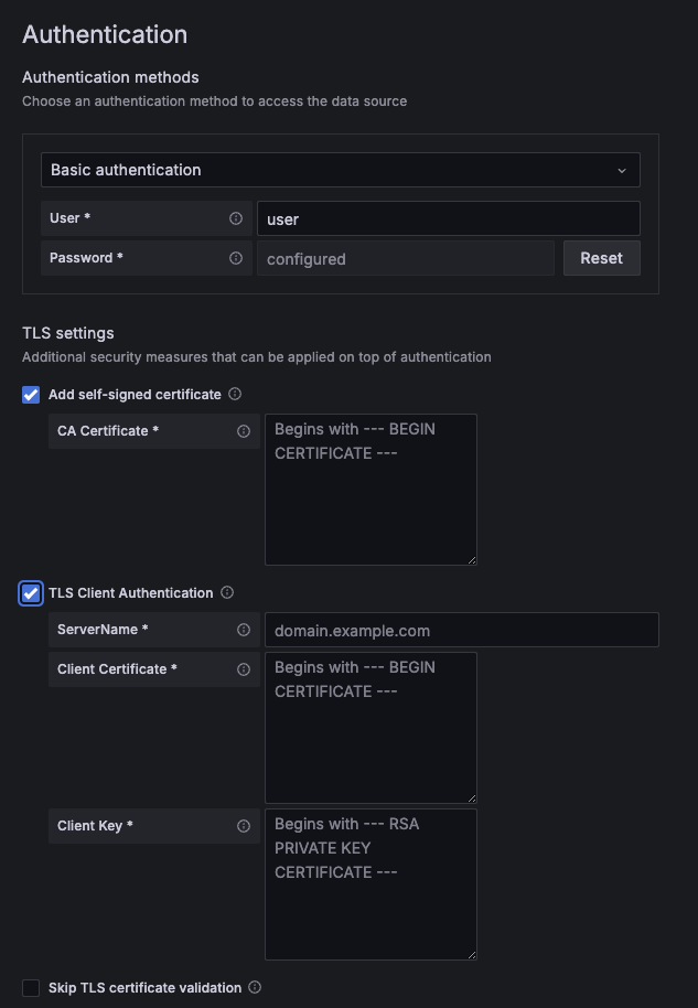

Authentication
Use this section to select an authentication method to access the data source.
Note
Use Transport Layer Security (TLS) for an additional layer of security when working with Pyroscope. For additional information on setting up TLS encryption with Pyroscope, refer to Pyroscope configuration.
To set up authentication:
  1. Select an authentication method from the drop-down list:
    • Basic authentication: Authenticates your data source using a username and password
    • Forward OAuth identity: Forwards the OAuth access token and the OIDC ID token, if available, of the user querying to the data source
    • No authentication: No authentication is required to access the data source
  2. For Basic authentication only: Enter the User and Password.
  3. Optional: Complete the TLS settings for additional security methods.
    TLS Client Authentication
    Toggle on to use client authentication. When enabled, it adds the Server name, Client cert, and Client key fields. The client provides a certificate that is validated by the server to establish the client’s trusted identity. The client key encrypts the data between client and server. These details are encrypted and stored in the Grafana database.
    Add self-signed certificate
    Activate this option to use a self-signed TLS certificate. You can add your own Certificate Authority (CA) certificate on top of one generated by the certificate authorities for additional security measure.
    Skip TLS certification validation
    When activated, it bypasses TLS certificate verification. Not recommended, unless absolutely necessary for testing. Authentication section showing the TLS client certificate options
