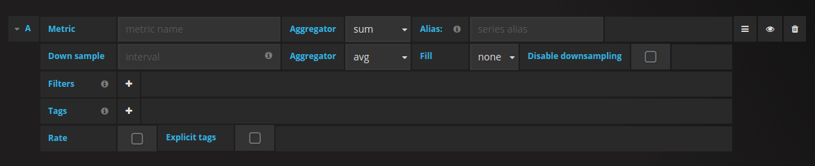

Query editor
Open a graph in edit mode by click the title. Query editor will differ if the data source has version <=2.1 or = 2.2. In the former version, only tags can be used to query OpenTSDB. But in the latter version, filters as well as tags can be used to query OpenTSDB. Fill Policy is also introduced in OpenTSDB 2.2.
Note
While using OpenTSDB 2.2 data source, make sure you use either Filters or Tags as they are mutually exclusive. If used together, might give you weird results.
Note
When using OpenTSDB 2.4 with alerting, queries are executed with the parameter arrays=true. This causes OpenTSDB to return data points as an array of arrays instead of a map of key-value pairs. Grafana then converts this data into the appropriate data frame format.
