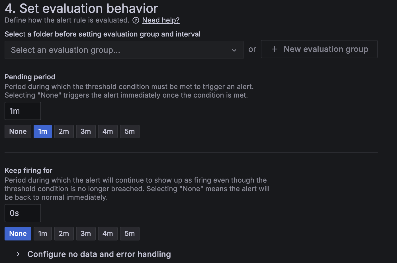

The criteria determining when an alert rule fires are based on three settings:
Evaluation group: how frequently the alert rule is evaluated.
Pending period: how long the condition must be met to start firing.
Keep firing for: how long the alert continues to fire after the condition is no longer met.
![Set alert rule evaluation Set the evaluation behavior of the alert rule in Grafana.]()
These settings affect how alert instances progress through their lifecycle.

Evaluation group
Every alert rule and recording rule is assigned to an evaluation group. Each evaluation group contains an evaluation interval that determines how frequently the rule is checked. For instance, the evaluation may occur every10s, 30s, 1m, 10m, etc.Rules can be evaluated concurrently or sequentially. For details, see How rules are evaluated within a group.
Pending period
You can set a Pending period to prevent unnecessary notifications caused by temporary issues.
When the alert condition is met, the alert instance enters the Pending state. It remains in this state until the condition has been continuously true for the entire Pending period.
This ensures the condition breach is stable before the alert transitions to the Alerting state and routed for notification.
- Normal -> Pending -> Alerting*
You can also set the Pending period to zero to skip the Pending state entirely and transition to Alerting immediately.
Keep firing for
You can set a Keep firing for period to avoid repeated firing-resolving-firing notifications caused by flapping conditions.
When the alert condition is no longer met during the Alerting state, the alert instance enters the Recovering state.
- Alerting → Recovering → Normal (Resolved)*
- After the Keep firing for period elapses, the alert transitions to the Normal state and is marked as Resolved.
- If the alert condition is met again, the alert transitions back to the Alerting state, and no new notifications are sent.
You can also set the Keep firing for period to zero to skip the Recovering state entirely.
