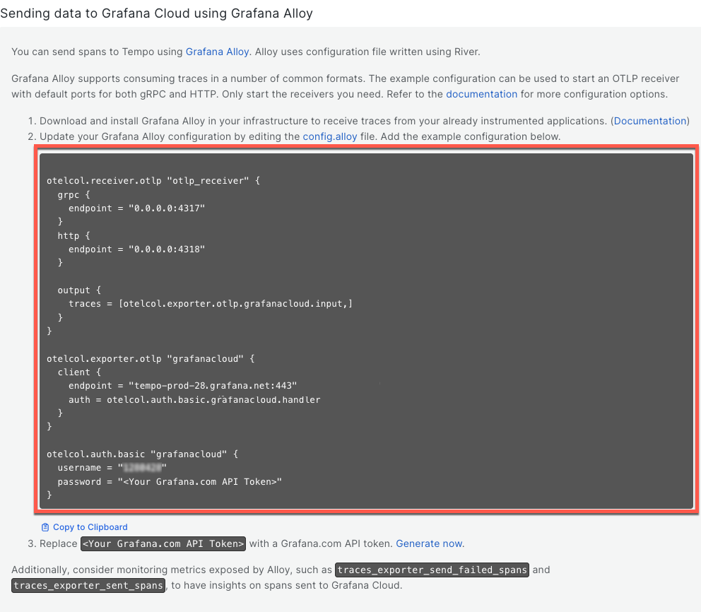

- Linux:
Copy the example configuration file from the Sending data to Grafana Cloud using Grafana Alloy section.
![Example configuration file]()
Paste your configuration into Alloy configuration file. Refer to Example configuration file for an example.

This example configuration file is for a Grafana Cloud stack with the default port and protocol and uses the batch processor for production environments.
If you use this example configuration file, replace the placeholder values in your configuration file with your actual Grafana Cloud credentials:
- Change
<YOUR_GRAFANA_CLOUD_TRACES_ENDPOINT>to your Grafana Cloud traces endpoint, for example,https://tempo-us-central1.grafana.net:443 - Change
<YOUR_GRAFANA_CLOUD_INSTANCE_ID>to your instance ID, for example,123456 - Change
<YOUR_GRAFANA_CLOUD_API_TOKEN>to your API token, for example,glc_eyJhbGciOiJIUzI1NiIsInR5cXXXXXXXVCJ9

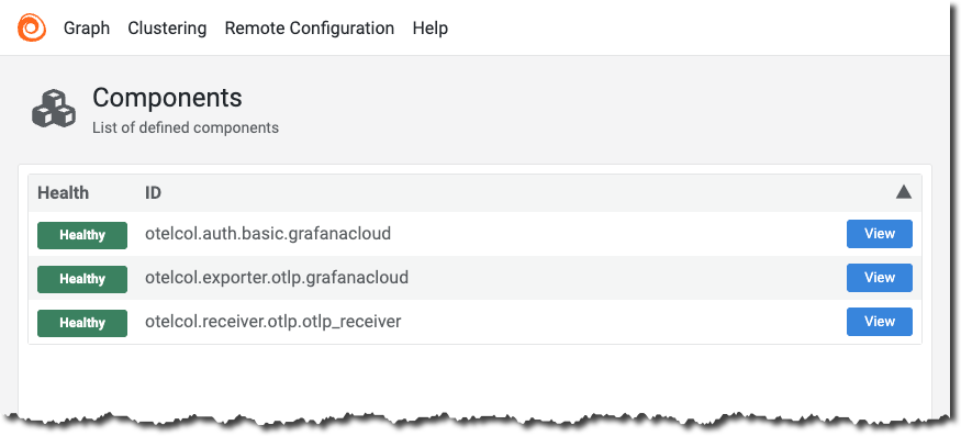

Check Alloy component status
To verify Alloy is running and check component status:
Open your web browser and navigate to
http://localhost:12345to access the Alloy web interface. You can use the web UI to monitor component status and trace flow.The web UI shows the status of each component, including the
otelcol.receiver.otlp,otelcol.processor.batch, andotelcol.exporter.otlpcomponents.![Grafana Alloy web interface showing the status of components including the otelcol.receiver.otlp, otelcol.processor.batch, and otelcol.exporter.otlp components.]()

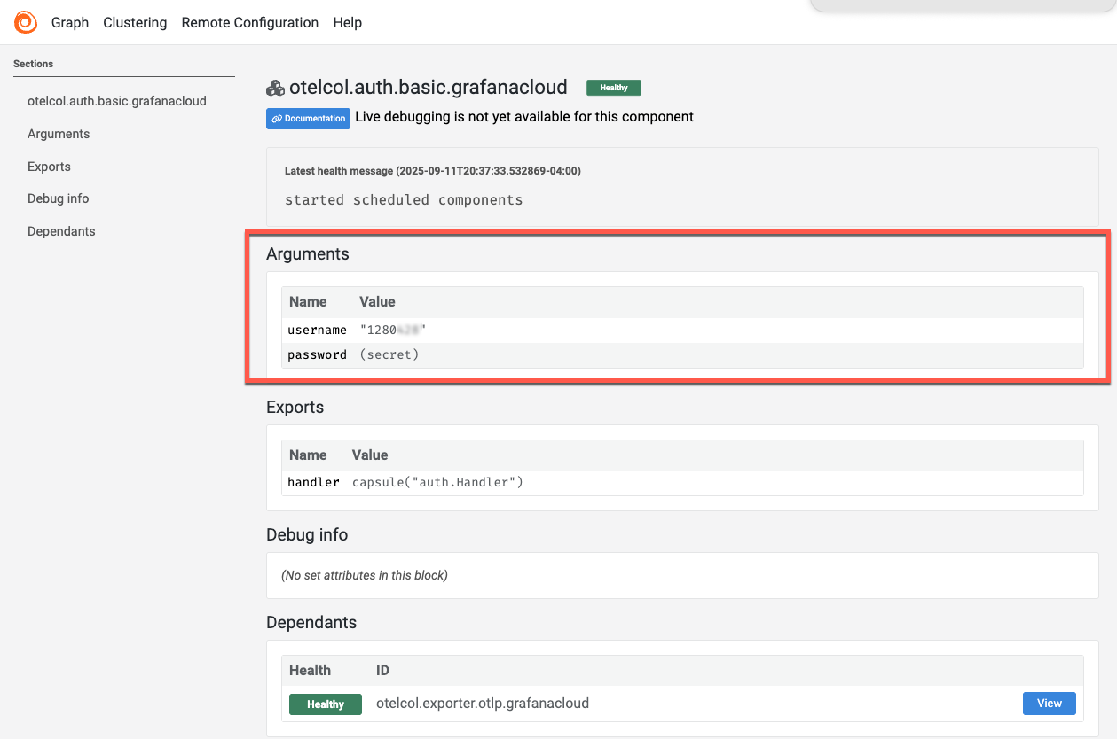

Verify authentication configuration
To verify that your Cloud username is correctly passed to Alloy, follow these steps:
- In the Alloy web UI, select
otelcol.auth.basic.grafanacloudfrom the Components list. - Under the Arguments section, verify that the
usernamefield matches your Grafana Cloud instance ID.![Grafana Alloy web interface showing the otelcol.auth.basic.grafanacloud component with the username field under Arguments.]()
