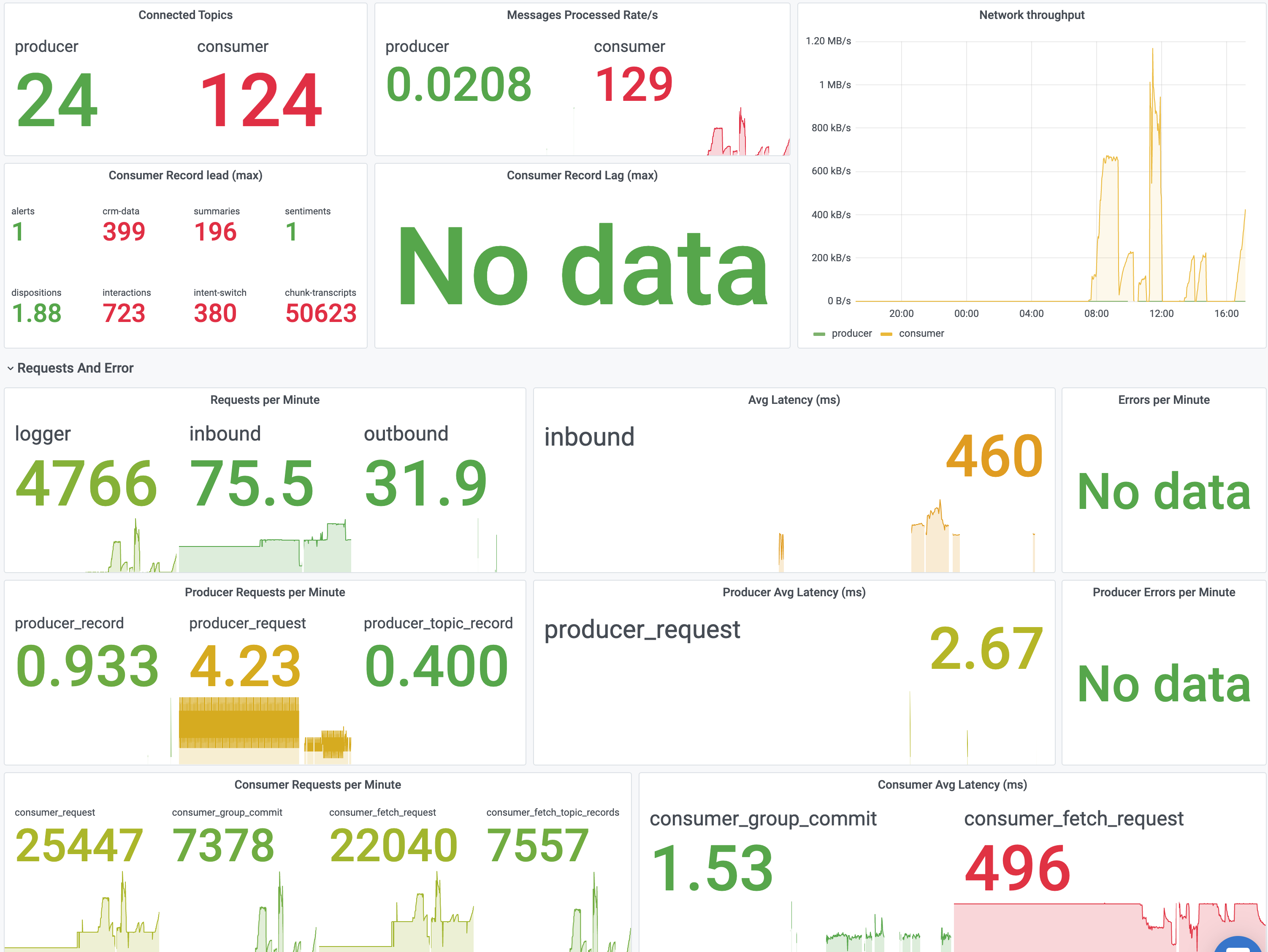

Dashboards
The following dashboard captures information about both producer and consumer of Kafka client.
- Topics connected to producer/consumer
- Producer records
- Producer requests
- Producer latency
- Consumer records
- Consumer Lag
