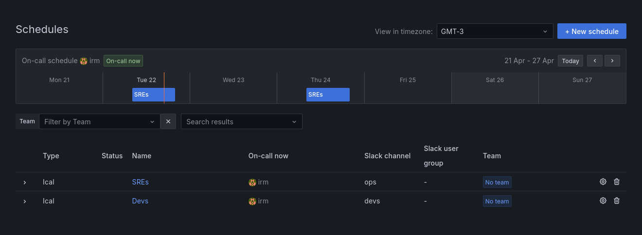

  • Two new Schedules named Devs and SREs are created in Grafana IRM:
    Devs and SREs OnCall schedules

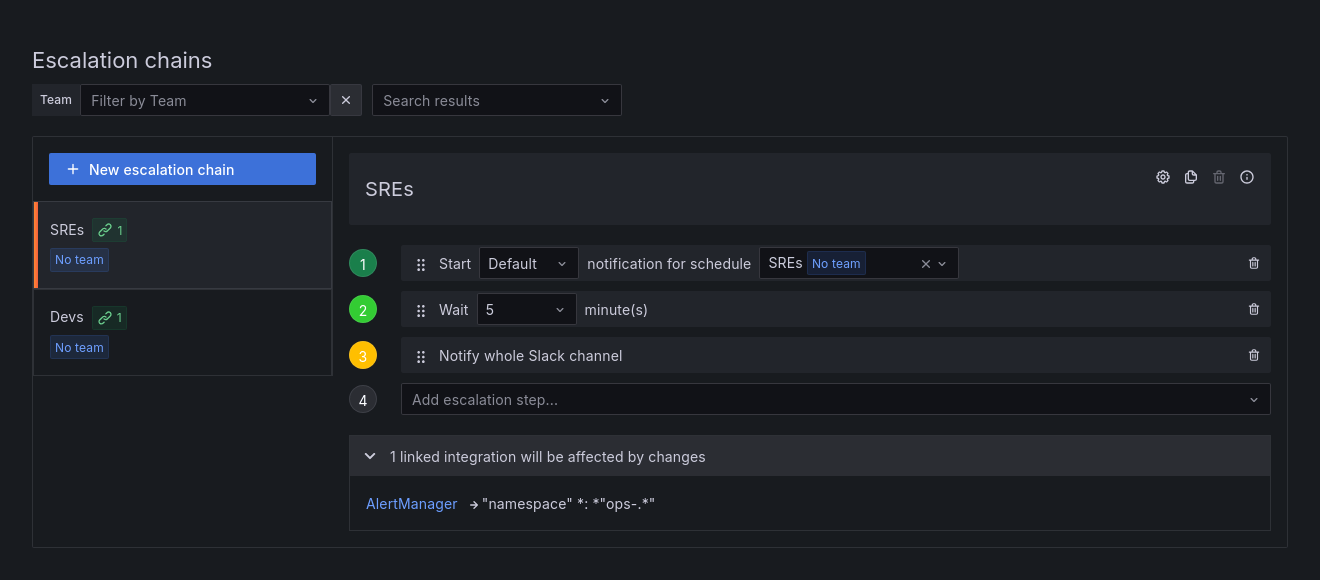

  • New Escalation chain named SREs is created in Grafana IRM:
    SREs escalation chain

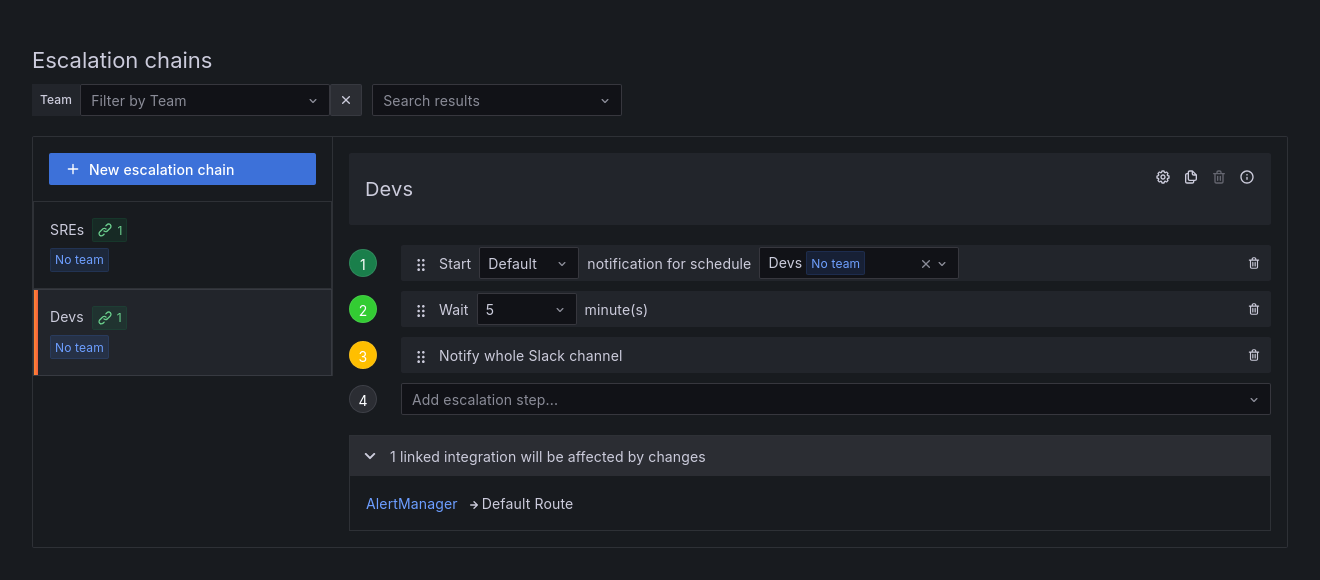

  • New Escalation chain named Devs is created in Grafana IRM:
    Devs escalation chain

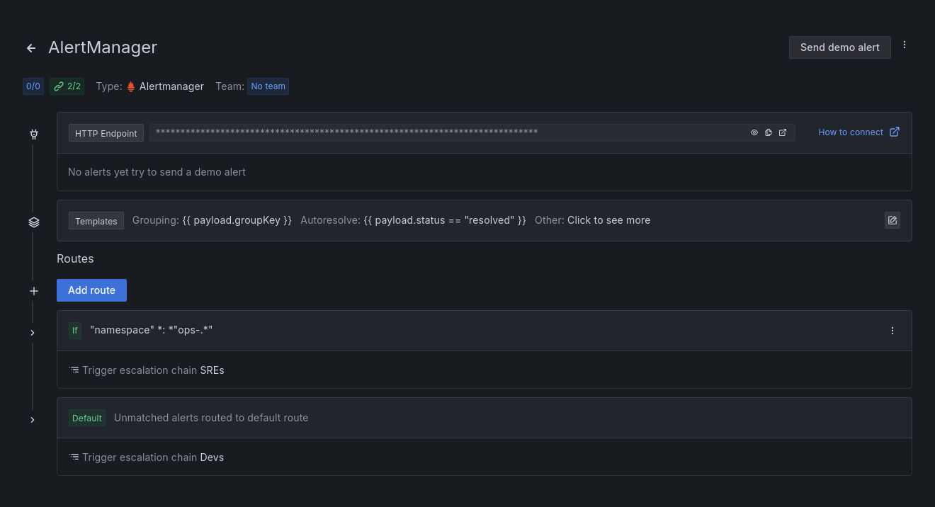

  • The Alertmanager integration is added and configured with escalation policies:
    Alertmanager integration for SREs escalation
