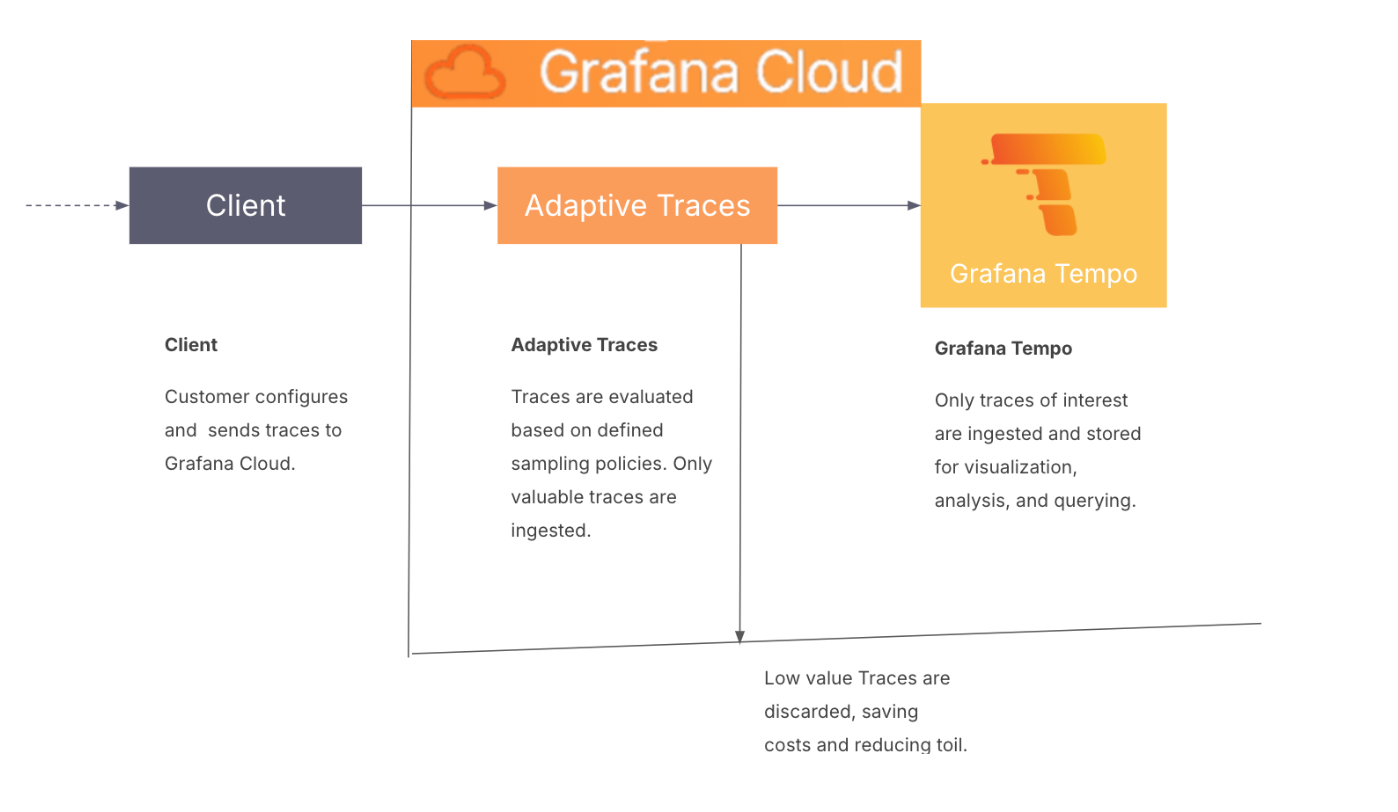

How it works at a glance
The following diagram gives you an overview of Adaptive Traces and introduces you to some of the fundamental features that are the principles of how Adaptive Traces works.
- Adaptive Traces performs what’s referred to as tail sampling, where the decision to sample a trace takes place by considering all or most of the spans within the trace. This sampling method gives you the option to filter your traces based on specific criteria.
- Sampling policies define a set of criteria that evaluates traces and decides which to keep (sample) or not keep (not sampled, or drop).
- Each policy has a type which specifies what information (for example, latency, string attribute) or condition (for example, percentage) is used for evaluation.
